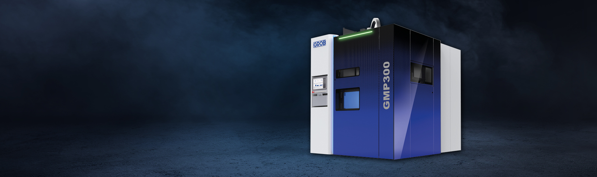

Innovative, economical & flexible: Thanks to the powder-free manufacturing process, the Liquid Metal Printing machine GMP300 by GROB enables safe and fast production of near-net-shape components. With the GMP300, we offer our customers reliable, efficient and cost-conscious plant technology with maximum production flexibility. Together with you, we develop additive-compatible components and thus unlock the full potential for your production.
Construction volume: | 300x300x300 mm3 | |
Positioning accuracy: | 0,015 mm | |
Var. droplet diameter min./max.: | 0,3/0,85 mm | |
Calculated max. build-up rate: | 199 cm3/h (250 Hz at 750 µm droplet diameter) | |
Building panel heating max.: | 650 °C | |
Control system: | Beckhoff TwinCat |
