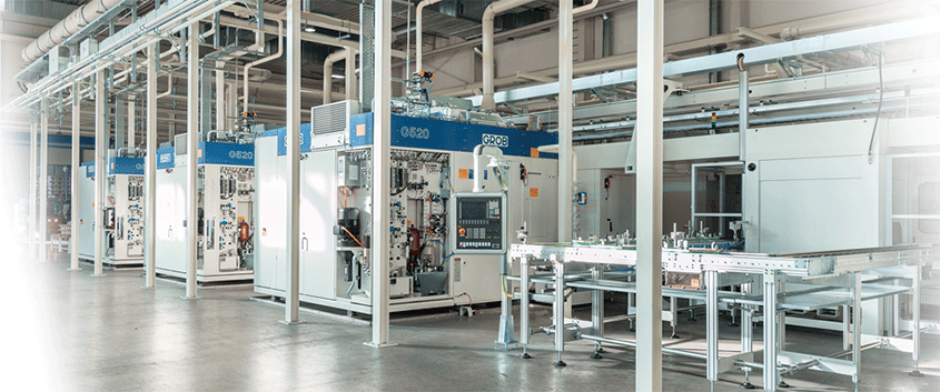

Autonomous and extremely flexible: GROB modular special-purpose machines are the logical further development of our transfer lines and are modularly constructed from standardized machining units. Thanks to their autonomous supply concept, they can be ideally combined with our G-modules to create hybrid manufacturing lines. Optimized precision guaranteed!
Advantages
checkboxCompact, modular structure
checkboxAutonomous units with integrated power elements
checkboxCan be combined with machining centers and automation solutions
checkboxMaximum standardization for highly precise machining operations
checkboxOptimized rigidity and dynamics
checkboxOptimum chip transport for MQL machining and wet machining
checkboxEnergy-efficient
checkboxFlexibly expandable
checkboxFaster retool facility
checkboxOptimum accessibility for operation and preventive maintenance

As an autonomous unit, every modular special-purpose machine has a separate hydraulic and electrical cabinet, as well as its own control system.
